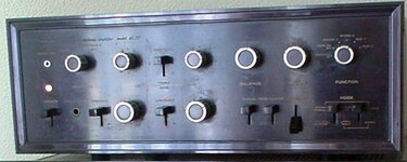

Forumite Johnnie came round a couple of days ago to deliver the "new" Sansui AU-777 (Thanks, MarkC (y) )
and then stated he wanted to hear these:
Tannoy Gold Monitor, 15"
...that were connected to this:
Sansui AU-111
But the audio quality was B-A-D!!! Very embarrassing, so I had to puzzle out what the problem was. The previous times I listened to the combo, the quality was good. Well, although the amplifier itself is no lightweight, those Tannoy cabinets that Perfectionist built are HEAVY! So I decided it would be much easier to drag the AU-777 to the sunken lounge and connect the Tannoys to it; this would determine whether the problem lay in in the speakers or the AU-111.
What a difference! So it appears that the AU-111 requires a bit of TLC, it had already undergone a cap-change some years ago and most of the valves, including the 6L6GC had been replaced. The volume is very soft and sounded muddy, I am suspecting that I might have a low HT problem but will determine this as soon as I make space for it on the workbench.
The Tannoys ROCK! Alan (@Perfectionist) did an excellent job on them although they really could do with a larger room.
Test setup:
Verdict: Both are keepers!
Oh, as is the AU-111, just needs a bit of TLC and it will be as good as new again.
